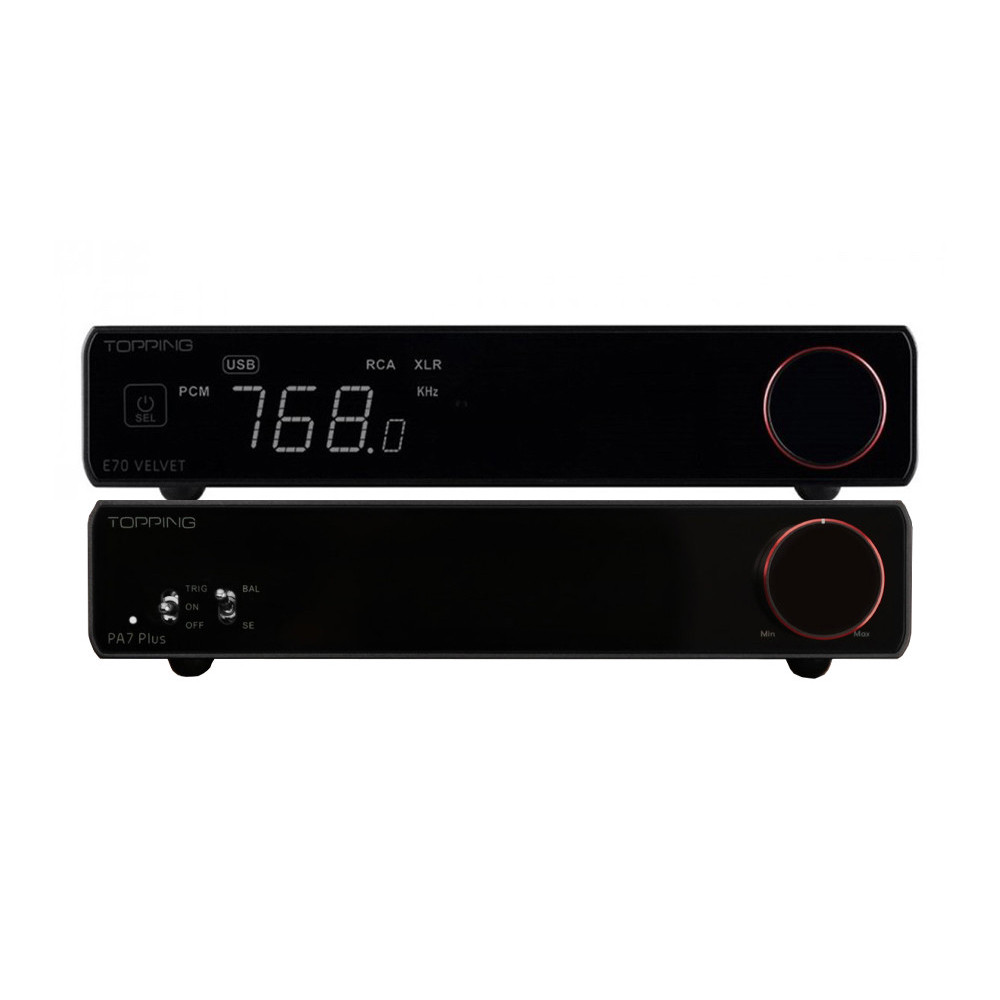

I have a Topping stack E70/L70/PA7. What is the best way to control gain for the best SNR? Should I use the L70 preamp to control gain and have the PA7 switched to bypass mode as a power amp, or should I set the L70 for no attenuation (pass-thru) and control the gain with the PA7 set to volume control? I was told that for the best SNR to run full signal to as late in the chain as possible?
I'd set the
E70 to 5V, DAC mode (volume control disabled), the
L70 to Low gain, -6dB for effectively unity gain, and the
PA7 to it's lowest volume.
I would then start listening to music and slowly increase the volume on the PA7 until I've reached the highest volume that I'll need.
After that, I would leave the PA7 knob where it is (maybe put some tape or a drop of hot glue on it so the knob can't get knocked out of position), then exclusively use the L70 to control volume.
Note that you can set a Safe volume on the L70 which it'll go back to when turning on or switching I/O.
That way, you can avoid unpleasant volume jumps when you start playing but left the volume too high from your last session.
I'd set the
Thank you, that's audiophile gold! - makes perfect sense, really appreciated.
Hello, I have a question to users of PA7 Plus. Is Your device getting really hot while using ? I have simple setup with Wiim Pro Plus connected to it. When I forget to turn it of, even without playing music chasis is getting rather hot than warm. Is this standard behavior ? Other class D like amp I have e.g. SMSL A300 with build in PSU is not as hot normally.
I have PA5, and it also heats up quite a lot, and structurally they are similar, except in PA7 the board is turned down by the radiator, which clearly does not contribute to better heat dissipation. Personally, I installed a small cooler - and the amplifier is always barely warm. On the other hand, my personal analysis of failed devices (from other users) is as follows: the damage is mechanical rather than thermal (I think that due to frequent temperature fluctuations and varying degrees of thermal expansion of components, that is, my theory is that the devices fail not because ofdue to overheating of the components, and due to constant on/off), but I still hedged with active cooling.
And yes, most D-class amplifiers usually don't heat up like that, but specifically for PA5/PA7, this is normal.
Very high heat components can have dissociated solder. It appears as if crumbly looking non-shiny solder joints and there might be donut rings cracks in it too. It then usually goes intermittent and causes serious issues. I have seen this often in amplifiers running 4 Ohms when the amp is rated to 8 Ohms and also for people that run the amps very hard at high output levels as well as amps with inferior designs. To do this requires very very high heat at components on the PCB. :D
«The truth is out there»:)

The Ifineon MA5332MS amplifier chip used in the A300 and the TI TPA3255 amplifier chip used in the PA7 PLUS have a large difference in power efficiency. The MA5332MS is an amplifier chip that pursues low power consumption and generates very little heat.

Absolutely nothing to be worried about, E70 will pair as well as any other DAC.
PA7 Plus will work well with any DAC/Pre with 1.9v (RCA) & 3.8v (XLR/TRS) or more.
