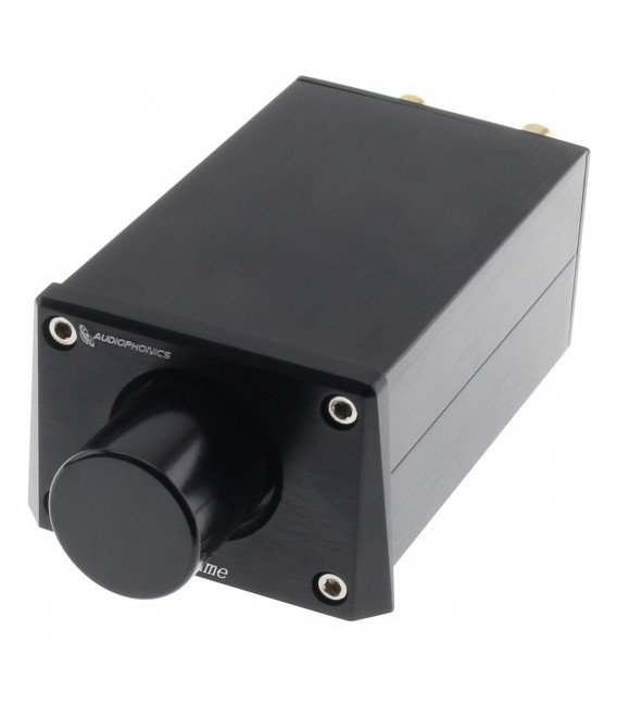

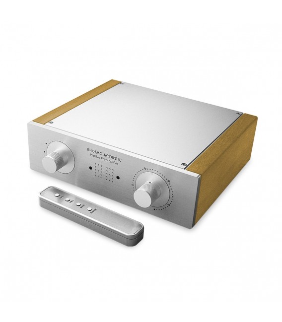

I just went the whole thread 'cause OP's and strea's problem kinda scared me 'cause I was thinking about a similar setup, to end up about to post the same device. Wouldn't it be a perfect safeguard ? Are there credible reasons to think it would degrade the audio signal ? Or do it at an audible level ?
The above one works for balanced setups, there's also an even simpler one for Rca to Rca with a 50K ALPS RK27 rotary potentiometer :
On the (much much more) expensive side, there's also this, with the practical advantage of having a remote :
