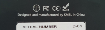

OH MY GOD! My SMSL DO100 does not have a CE mark on its back!!!
Yes, but look what happens if you turn it upside down..............
MAGIC!!! PSE, FCC, CE and RoHS marks. No rule states that these should be on the back of the device, the underside is legal too. Sometimes internet pictures are not enough to draw conclusions.
Nice to see it )) thanks oufff
You are absolutely right : my bad ))

Where ?
( I would be happy If Im wrong on this )
On the back. But why your question, do you think that forum members are just lying for fun ?
i think there's a general thought that SMSL, being Chinese, can't possibly be doing things by the book... they wouldnt be complying with accepted western standards... and I just had a quick look at my half dozen SMSL products down to the $30 ps100 and they all have the same four certification marks.
If they bother to do it on a $30 unit then I'm pretty sure they would do it on a $200 unit too.
on some units its on the back but if there's no room its underneath
