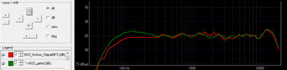

Following is a system spl characteristic comparison from Klippel NFS (red) and gated/NF with VituixCad crossover simulation (green).
I expected 330Hz resonance to show up on NFS (as gated measurements has some smoothing effect) but it didn't.
The discrepancy below 300Hz is probably a result of not using baffle diffraction on the NF measurement. I neglected it due to the small enclosure dimensions, expecting a "single dB" error (post #4). Apparently the effect is more prominent, at least 2.5 dB as I read it from the chart.
Below 60Hz both characteristics get closer together which is a bit strange. It seems that lack of diffraction is not the only issue with my data processing. The effect occurs where port response becomes strong (near the BR tuning frequency) so one explanation that comes to mind is that the scaling factor of the BR port response did not exactly match the NF measurements performed.
Did you have to match the port response "by eye"? That's always the most guesswork in VCAD for me.
