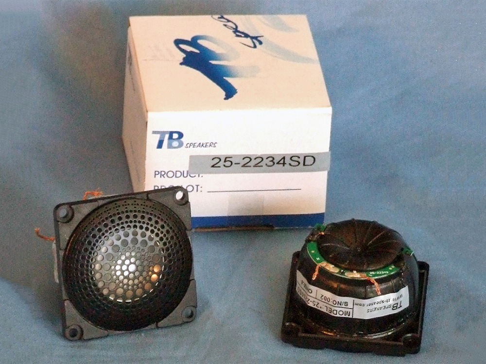

The fact that most people stop measuring speakers at 20kHz does not mean the tweeters cannot reach above it.
The ones that start to peak at 20kHz will certainly go higher than 20kHz anyway, also the ones that measure flat up to 20kHz are certainly reproducing above 20kHz.
For the same reasons headphones are usually only measured up to 20kHz. These measurements are not accurate above 10kHz anyway.
I measure them up to 30kHz (where the mic starts to drop off) and have seen quite a few headphones reaching to at least 30kHz.
