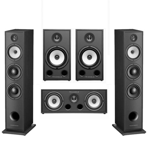

Are the triangle BR08 worth a damn? Just seemed like a good deal but very unsure.
