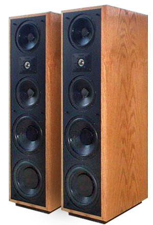

This curve reminded me of a long gone speaker I used to own, that was tested by Stereophile back in the 90s... The Polk Audio Rta11t. It had an MTM arrangement, and a simple 2 way crossover.
But my ONLY reason for going a bit off topic, is that THEY had almost an identical overall response ON AXIS, but with actual listening, have to be honest, sounded for the most part relatively even and neutral, at least in the area with the dip. Not actually heard in any room I used them in or with Female Vocals..........
So, have to wonder if this is more an artifact of measuring, but the OP says they sound bad, in fact oddly bad??

The red line in my measurement above, was in-room, at 4m distance (compared to the estimated in-room).
As for the Stereophile measurement, It's possible. Unfortunately, the in-room graph is low-res (one of his older reviews).
"Again there is an overall lack of energy in the crossover region, while the peak centered on 12.5kHz noted on the anechoic traces results in a significant boost in this region in-room, noticeable on all axes."
As for the regular measurements:
"Fig.4 Polk RTA 11t, anechoic response on listening axis at 48" (black), and on tweeter axis (red)."
48" (~1.2 meters). Tweeeter axis = Between the midrange drivers. Listening axis = level with the cabinet top.
