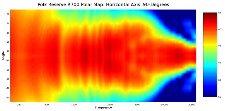

Bigger brother R700 floorstander just reviewed at Audioholics:
Wow, that’s really good.
Looks like Polk’s Klippel NFS was put to good use. :)
What a shame though they used that ring radiator tweeter which beams too much in the upper octave.
