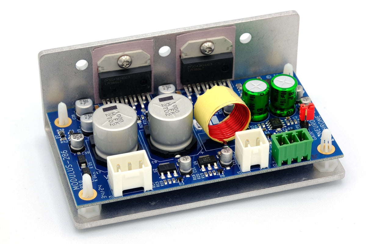

@ppataki
Alternatively if you have the skills and avoid loosing the 400 bucks return shipping. Throw out the amp sections, keep the cases and the PSU and stick for example something like this in it.
SINAD ca 107dB
Plus the fun and bragging rights that you built it :)
