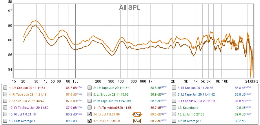

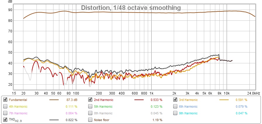

Many have asked what is typical. As I reported in another thread, I recently obtained and refurbished a Teac 4300 deck for a special project. I’m not sure I made it perfect, but I was able to use REW to measure it—REW sweep to the record input and listening to the playback head tape monitor. Three head decks allow this.
Ignore the magnitude of the dB scale—that was normalized to whatever I measured with my SPL meter when I last measured my room. Recorded level was actually -8 dBm at the inputs (-18 dB VU)—“operating” level. This is after calibrating the record bias to Maxell high-bias tape. It’s limited by 7-1/2ips tape speed.
Frank mentioned bass head bumps and they are there. But the response is better than the spec, which is a 6-dB window from 30-20KHz at 1.5% THD, with an S/N of 58 dB (no Dolby). This did better than that:
And, yes, this sounds pretty good, which I interpret to mean our ears aren’t as picky as our intellect thinks they should be.
Rick “who would expect the Otari to do better” Denney
