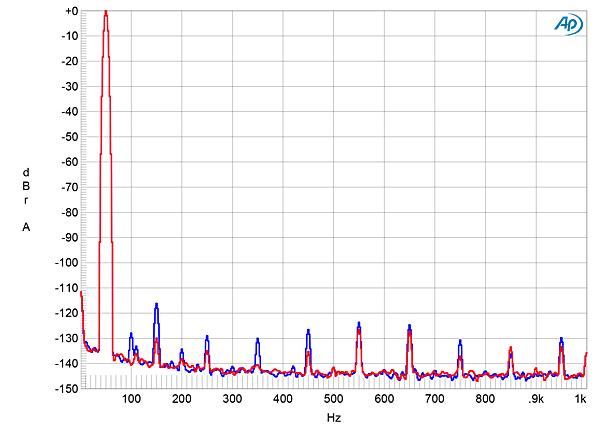

Accuphase offers very good quality and long-term serviceabilty, but you pay extravagantly for the look and long-term guarantee.
The DG-68 at $24K does measure well (attached here for the rest of the audience), but here's the thing...
If you took your Maestro Utopia Evo at 76K with the $24K DG-68 and $51K/pair A300 and $25k DA-1000. ($176K)
