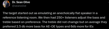

Hi! For contextualization, Waves NX plugins now use the Harman target as the standard target curve to make headphones "flat". It makes little sense, here's why: The Harman target is supposed to emulate how flat speakers sound in a well treated room. So, by applying this equalization to headphones and then using a software that reproduces the sound of another studio, you're basically not experencing how that studio truly sounds. It's almost like you're doubling the effect, even though it's not really like it. (I've attached a tweet from Dr. Sean Olive to prevent missinterpretation. Yes, that's what the target curve is meant to do).

The goal of the research by Dr Olive's and colleagues was to find out how to make headphones with the highest listener preference rating (averaged among the listeners). It wasn't intended to emulate any room.
