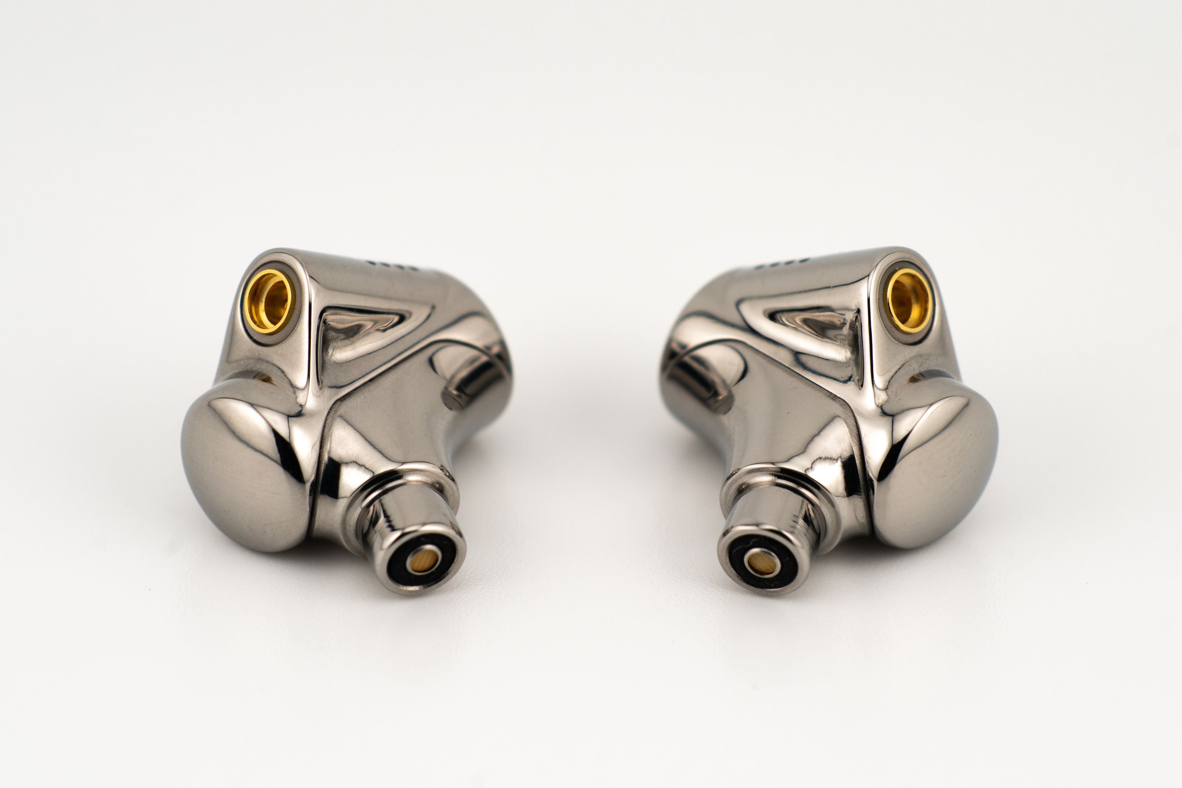

This is a review, listening tests, EQ and detailed measurements of the Hidizs MP145. It was sent to me by the company and costs US $150.
The immediate impression of the shells is one of jewelry with its machined aluminum case. As you see, the included cable has 4.4mm balanced connection even though it doesn't need that (plenty sensitive to work fine with 3.5 mm unbalanced). Included in the case are three tip variants and nozzles (latter not shown):
As is typical, medium size tips match my GRAS 45CA measurement artificial ears best. But for listening, I have to go one size larger. I started with balanced tips but then tried to measure with the other tips. I found the process of swapping tips very difficult. The nozzle is large and the tips barely fit it. Good news is that once you get them on there, they going to stay. With some other IEMs I have had the tip get stuck in my ear while the IEM detaches! :) The measured difference with the three tips was very small. Given how hard it was to do this, I did not attempt to change the nozzles so the measurements you see are with the default ones.
The drivers in this IEM are planar magnetic which is a deviation from many others.
