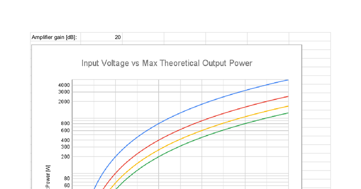

This spreadsheet may be useful to you:
To use it, login with your Google account and go to File->Make a Copy.
In that copy, you can change the Amplifier gain and the graph will update automatically.
It doesn't matter what the sensitivity of the speaker is. The only thing important is whether the max power of the amplifier can be reached given the input voltage you have. As I noted, this amplifier needs 2.8 volts input to do that. Since most DACs have 4 volts output, you are good to go regardless of speaker you use.
