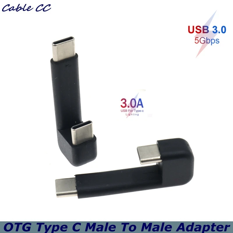

thanks @staticV3 ! a related info: I want to buy the 180 degrees male/male adapter but I'm struggling to find it, only AliExpress seems to sell it:
am I right? anything on Amazon?
If you can't find the same adapter on Amazon, then you could replicate it with a type c to type c u shape adapter
plus a type c male to type c male adapter.
