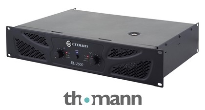

Thanks. Would this also be a good candidate?
Based on specifications, I would still recommend those Hypex module based amps from the likes of buckeye amps. That's on paper only, in reality, if you need the output for your application, then the Crown amp could be a good choice. Just that, at low listening level in a very quiet room, combined with sensitive speakers, noise may be audible as even at the lowest gain setting, at 29 dB, it is not low enough to improve much on "noise".
