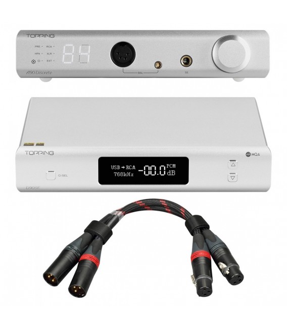

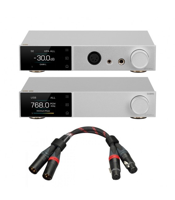

One or two setups that could do it with a Stealth in terms of power:
  • Topping A90 Discrete Measurements Power into 32 ohm Headphone Amp Preamplifier Balanced.png
They are ugly and expensive (IMHO), so they'd better sound good!
