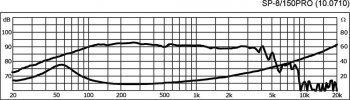

This combination, if one finds a suitable bass element, could perhaps be something:
Maybe together with this 8 inch bass driver, which is used in this kit:

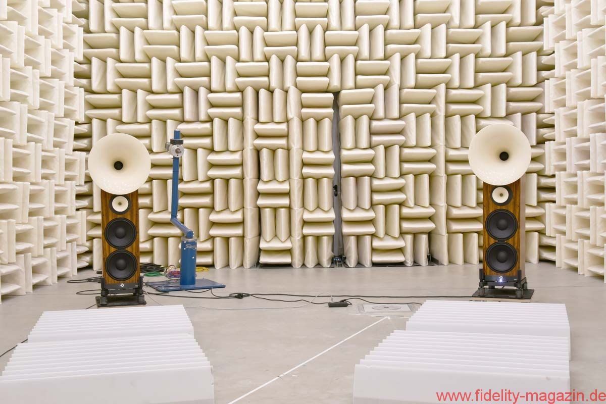

The Avantgarde Uno/Duo measurements below and on Stereophile show why so many ways are needed:
