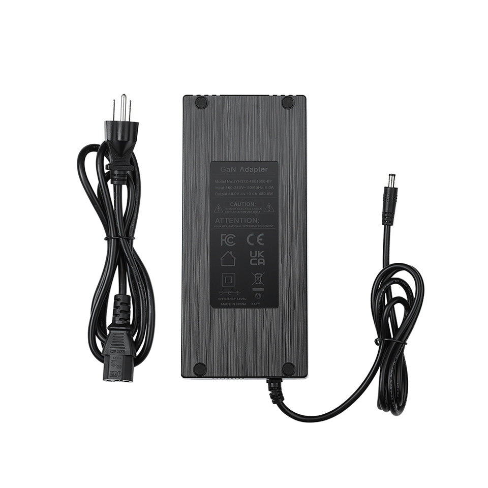

Hello there, is there already any insight on the new AIYIMA DC48V 10A GaN supply?
Herr are 2 links to it:
Hi I'm really not liking a fan hole in that PSU the only time I've seen that are low level apple PC's where the Power supply unit needed to be flat and low, but there's no exit hole?
Is there even a small fan in there?
What happens when it's collected dust and fur?

Has anyone tried the AIYIMA 350W @ 48V aluminum case PSU, priced around $70-$90? (https://www.aliexpress.com/item/1005001493689010.html)?
After doing a lot of research on AliExpress, I found out that the assembled PSU PCB inside seems to be quite inexpensive—about $25 including shipping. Here's the PCB:
Left image from: https://www.aliexpress.com/item/1005006800930543.html
Right Image from: https://www.aliexpress.com/item/1005005864004846.html
Because of this, I'm considering building the PSU myself. You can get the same aluminum case for around $20 here:
However, I'm a bit concerned about the quality of the PCB. Does anyone know more about these 350W supplies?
Another option is to get the A07 Pro, bundled with a 48V, 5A brick PSU for an additional $25. (https://www.aliexpress.com/item/1005005041367134.html)
I'd love to hear your thoughts or any feedback
