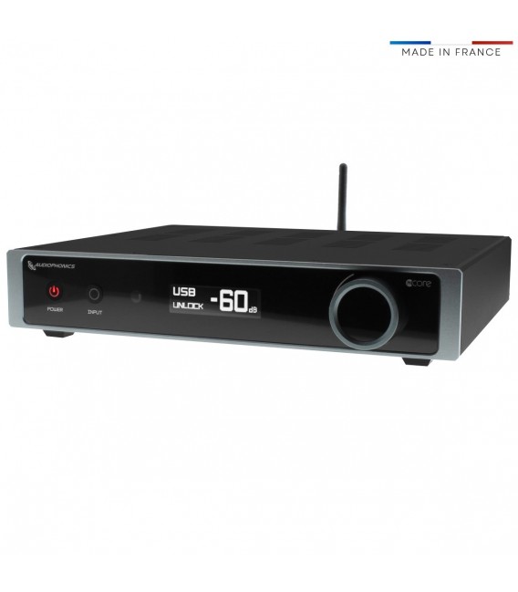

During the week i ordered the Audiophonics LPA-S400ET Amp from France. Waiting for it to arrive here in Sweden, I hope during next week.
Summarizing above comments and tips:
  • The Yamaha RX-A2080 that I have has "quite a lot" of power but has problems with lower speaker loads from what I understood.
    • In real life with the Yamaha the audio is quite clear and dynamic but I mostly lack level and feeling in the midrange. More of a U shaped curve.
    • I borrowed a friends XTZ A2-300 amp and connected to the pre out on the Yamaha. Quite big difference. The sound is a bit more powerful, controlled and even in the bass, and especially the midrange got a nice level lift so I could hear vocals more clearly. The treble seems more rolled off and rough though. And the sound with this amp is not very detailed (except for the bass region). So I hope the new LPA-S400 AMP will do the trick of giving more control, a nice more leveled curve and more details. :)
