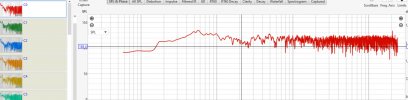

I saw this and appreciate it. However, it doesn't offer a "zero curve applied" outcome. My room curve comes from Audyssey equalizing to flat and then using Dynamic EQ, nothing else. No smoothing 10-300 Hz:
At Audyssey's measured 75dB (-30 dBfS scale) level, this is Flat vs Dynamic EQ default (0dB):
DEQ effect is far from an application of the slight tilt a speaker's steady state response is supposed to fit. It tries to fix the absurd HFR1 reference curve at the high end and boosts the bass massively in the low frequency band for all practical volume levels. IMO, Audyssey has confused reference level peak with the reference level itself (105dB vs 85dB - Reference level is mastered in studios at 85dB with highest peak to hit 105dB) in the original design and they continued to stick with that all these years generating false excuses instead of a fix. DEQ 0dB has 0 effect at 105dB (which should have been 85dB), DEQ 5dB has 0 effect at 100dB (105 - 5), .. DEQ 15dB has 0 effect at 90dB (105 - 15). So, the DEQ strength also has nothing to do with music or movie listening as claimed. Add to these another 6dB for surrounds and 3dB for the heights!!!
There's a high pass 6dB/octave Butterworth filter at 15,75Hz embedded in the units causing the tilt at the left end of Flat. When DEQ is on, no filters are applied below 24Hz. Subwoofers are applied either one of these two filters by default: Linkwitz Riley 24dB/oct lowpass at 120Hz or at 250Hz distinguished by "isReversePolarity" property in the calibration file. I can go on forever ;)
Ok. But if you follow that through to its end result, you'd have very little bass. In fact, nearly everyone who has used Audyssey says they did not have nearly enough bass post-calibration with DEQ off. I'd be interested to hear your thoughts on why that is. Because with DEQ on, bass levels are much closer to perfect. And it's not just the overall level of bass, but the shape of it that sounds great to me--and that it's consistent at all volume levels, something I can't say about systems without DEQ. I've always thought that they really spent some of their R&D on getting that right.
...nearly everyone who has used Audyssey says they did not have nearly enough bass post-calibration with DEQ off...
It is true. For me, Audyssey set the LCR speakers to fullband and there was not enough bass. It was enough to reset the LCR to small 80Hz and the bass was almost like DEQ. DEQ itself is terrible.

So things have moved along a little.
After more than just a little casual listening that resulted in the quoted statement, I realised that I was really lacking some (a lot of) bass.
So I tried the suggestions above in @OCA s post above to achieve something resembling the Harmon Kardon curve - in particular enabling Dynamic EQ. Bass came back - in spades. Unfortunately much too much. It felt like it was thumping me in the eardrums (like the beating effect of having the rear windows of a car partially rolled down)
So now I've gone into options on the AVR, and turned down the sub level about 7dB. This sounds about right now. However, I'm guessing I am not getting the ideal smooth response by doing this, since just adjusting the sub level is to coarse a band.
So I'd like to try adjusting the Toole target curve to increase the slope. I'm thinking if I multiply all the values by a factor to do this, then subtract an offset to keep the maximum boost at the peak of the bass the same, this should achieve what I want - like the picture.
What do you think?
(Green is the Toole curve, Blue is the modified curve)
Or do I just need to add a bass "hump"?

What you can also do, that's what I have done and it gives me better bass, is use the Harman Curve instead of Toole's. This adjusts the bass nicely.
Where do I get that from?
Thanks
