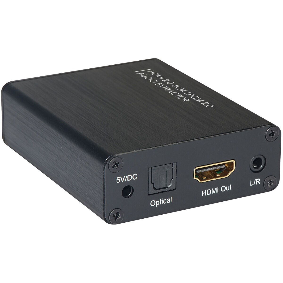

For stereo (OPPO to RME ADI-2 DAC), I use this $40 thingy
