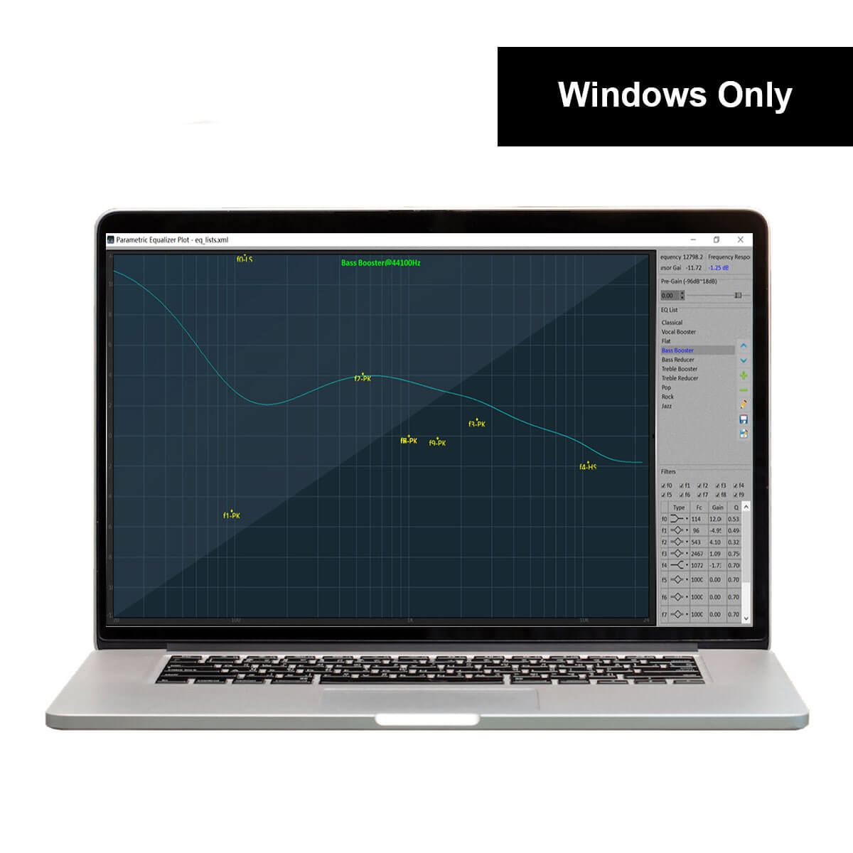

It is imperative to feed it in 16/48 if you are going to use it to listen to music from a computer (Roon, Audirvana and co do this very well) and not under a television to avoid bad conversion of sampling done as input because the DSP is under 48 Khz...
In fact Arylic has this product... but for the quality...
And this application for use
And on ASR

PLUS they need to get an app up and it has compatilibty with ACP workbench but that's another $20... the reason this unit even exists is because its their B50 amp with the amp stage cut out. And so the performance here permeates their entire '50' series lineup.
