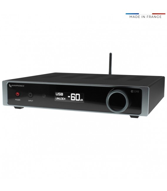

Just saw audiophonics has integrated amps now. Ncore + ESS9038Q2.
What's the opinion on this ?
That it would be great to see measurements
