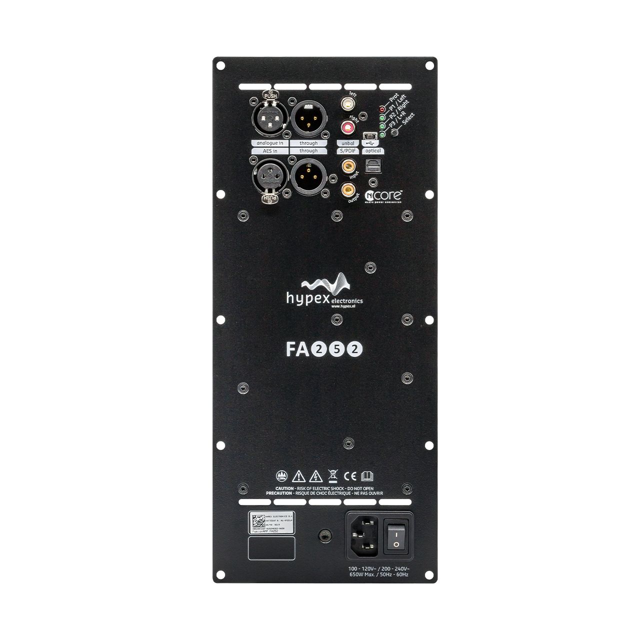

which amplification modules will the active version use?
Hypex I believe.
Yeah, kinda looks like this one based on the rendering.
https://www.diyclassd.com/products/fusion-amplifiers/fusionamp-fa252

Question: You probably have a solution for this, but the interior pictures seem to show that the amplifier doesn't have its own chamber, but the hypex plate amps have vents in the plates, which means you won't have a completely sealed cabinet?
