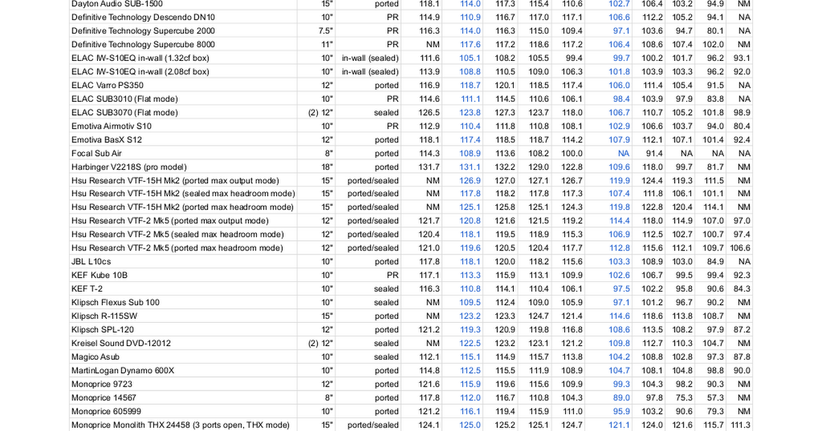

There's a good list of subwoofer comparisons on this forum as well here:
Towards the end of the above linked post, is a database of subwoofers and their measurements here:
There is also this additional list of subwoofer tests with room sizes, with an excel file you can download at the end of the article:
