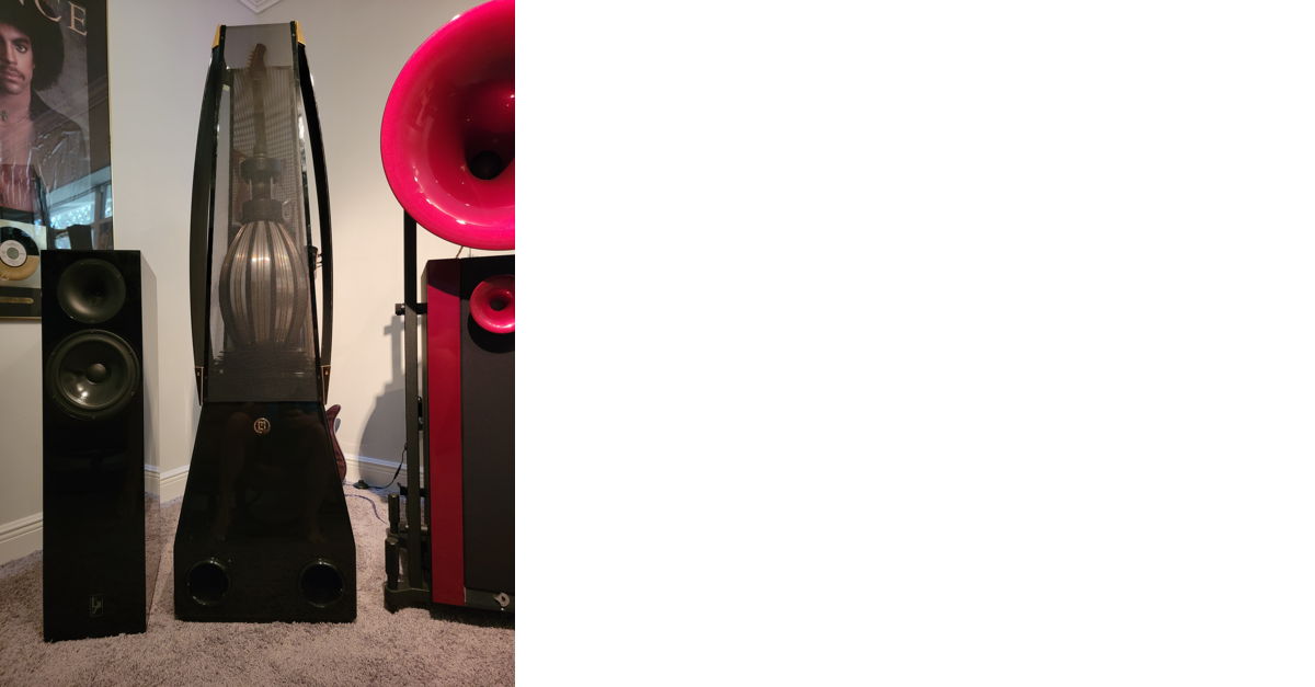

AAaaagh !
A killer, rare secondhand deal for my dream speakers!….
If only those showed up during one of my better work years, they would be mine now!!!
Do you recall what the price was? It's annoying that Audiogon removes this information.

As I recall around $15,000
