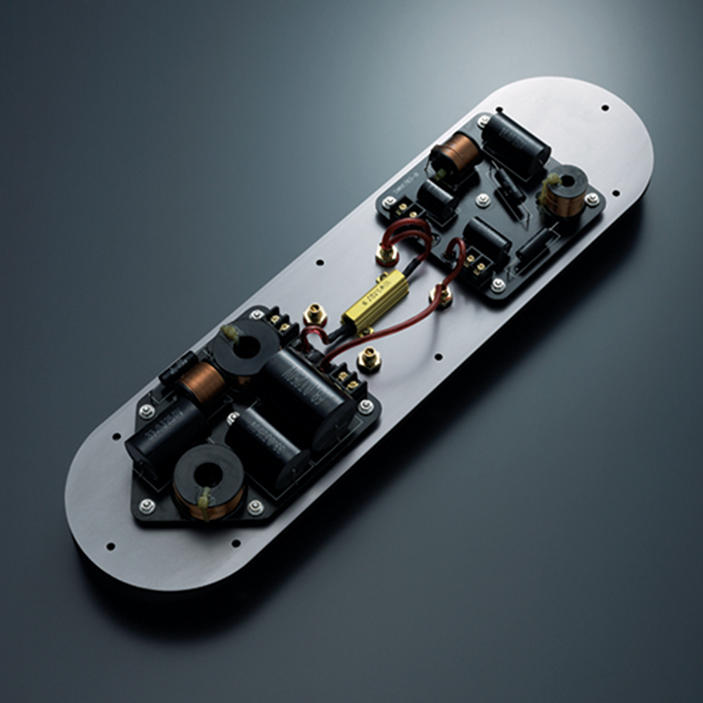

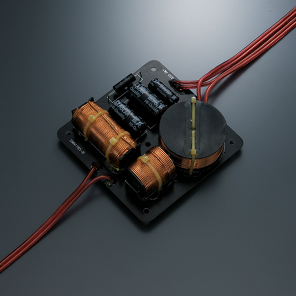

Passive speaker designers traditionally find a three-way speaker troublesome - apparently - and many stick to two-way. For example:
In other words, the passive approach cannot make a good 3, 4, 5 or 6-way speaker regardless of cost.
I would say the passive approach can lead to a very good 3-way speaker, e.g. https://www.pioneerelectronics.com/pio/pe/images/portal/cit_11221/420272384TADR1OwnersManual0228.pdf.
But it would cost you.
