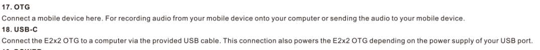

I see the E2x2 OTG adds a second USB-C port (labeled "OTG") and an optical S/PDIF Out.
- The function of the S/PDIF Out port is clear enough, if limited to stereo. No ADAT? I guess not.
- Is the OTG port only for playing to or recording from Android phones and tablets? Perhaps Chromebooks?
Also must working with iOS, iPad. When connected to Mac it recognised as 2-in/2-out audio devise 24-bit 48kHz, and topping software don't recognise it. So when connected to computer using OTG port, you don't have routing control from topping software and you have restricted functionality(in/out channels and sample rates).

Also as an aside for those that think this is important. I noticed the new E2x2 OTG variant not the regular E2x2, has the ability to attach a mobile phone and PC at the same time.
I bought this audio interface for the off chance I could use it with my mobile phone and PC at the same time and route the channels for meetings where some people are on Microsoft Meeting and a remote person calls in to my mobile phone, where that person can hear the people in the STREAMED meeting and talk to them at the same time through my phone to the E2x2 OTG. It DOES! No more putting them on speaker phone and trying to get the headset close to my headset and speakers for them to join. This is also great for people who are gamers where a phone call comes in and he has to pick up, conferencing in late coworkers into meetings, and not having to take off your headphones when a call comes in. It also lets you record the call (legally please!), use the headphone amp and headset microphone for mobile calls. I use a Rode VXLR Pro 3.5mm to XLR adapter to my Sennheiser PC38X, with Phantom power and this is a keeper for me!
I'm hoping the next variant has optical input as well as output with 8 channel ADAT. I'm hoping their 8x8 has INPUT and output 8 channel adat as well to expand other audio interfaces.

What phone do you use?
For me, with Samsung S10e as well as a collegue's Samsung M30s, it doesn't work at all - no output when connecting with OTG port, and no input to phone regardless of normal or OTG port. With additional power, too.
See
Post in thread 'Motu M series with Android, anyone'
Contacted Topping because of that, let's wait what they say.
