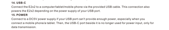

Hello it’s me again, sorry but do I need to use additional power? I’m currently using just usb c to usb c to my pc, works fine with headphones. I didn’t plug in sm7b yet, do i need that 5V thing or i can just plug power into my pc also? So “usb-c” and “power” both go to pc is that ok?
Page 12 of the user manual:
Plugging in an additional power supply is not mandatory.
Plugging both USB ports into your PC achieves nothing.
Plugging both USB ports onto your PC achieves nothing.
I see, thanks! I have other Topping products, like a DAC and an amplifier, and they all have two cables — a USB cable and a power cable, often with a power adapter. So it seemed strange that in this case, where both the DAC and amplifier are in one interface, only a single USB cable is needed. Also, I have a question: the power button is located on the back — is it okay to leave the device on 24/7, or should it be turned off periodically?
