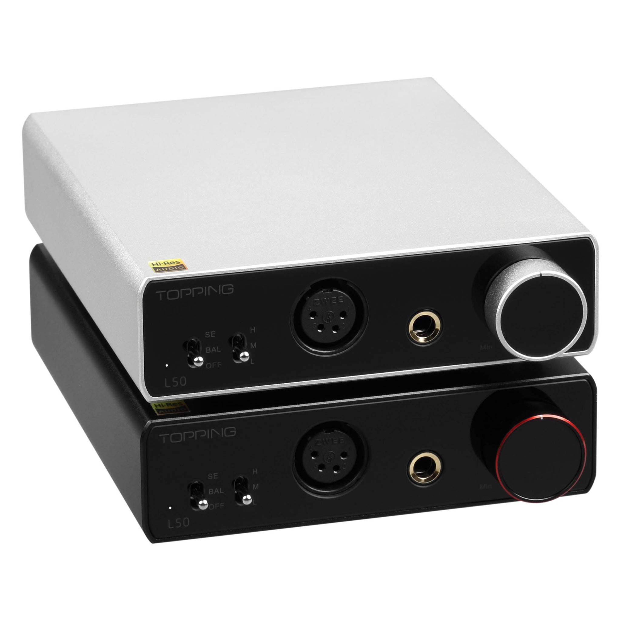

I think the DX3 Pro+ is ideal for a work-from-home desktop arrangement where you frequently switch between active speakers and headphones. For a dedicated headphones rig, I'd be looking at something like the E50 + L50 stack. For example:

You could also buy the L50 with the apple dongle and save for a dac, D10B is relatively inexpensive.
