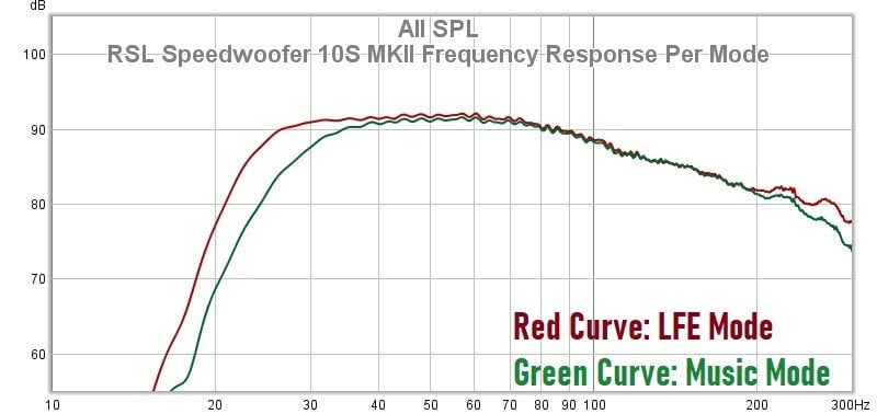

https://rslspeakers.com/speedwoofer10s-mkii/
449$
https://www.audioholics.com/subwoofer-reviews/rsl-10s-mkii
