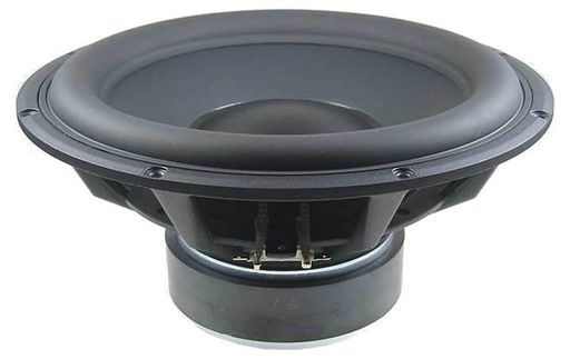

Subwoofers are pretty simple devices. You could look to local companies that use known good drivers in closed boxes. BK Electronics in the UK advertises a few subwoofers with the excellent Peerless XLS or XXLS drivers. Their 12" one (similar to SVS SB12/SB2000) is listed as sold out, but the 10" version is available: http://www.bkelec.com/HiFi/Sub_Woofers/XLS200.htm
You might have a local maker that uses these drivers as well. Look for the bevel on the basket rim. There are other excellent drivers, but because of that unique bevel XLS/XXLS are the easiest to spot from the front at a glance.
