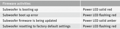

Isn’t the answer to your question written right underneath the LED?
Red means protection is active (or the sub is booting up) which is a different status. The LED was amber colored, as pictured in my post. According to the manual, amber indicates a firmware update.
From the manual:
I haven't had this problem yet and the LED also lights up amber when sub ist muted.
