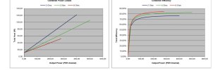

SPL of two combined speakers
I dont think it is that bad as you say. for me looks ok. only bigger problem is at 10k and a bit at 5k, I think you just need to adjust mic position to get this a bit better or speaker, easier with the mic first. everything else can be done with preference EQ. I recommend that you dont average anything, smoothing 1/12oct is workable if room not that good, but helps to p… off yourself when seeing things without averages sometimes, to force yourself to make it better, you need to hate this as a trigger to make it better :)
The issue is the speaker placement. Not optimal, but what I have to work with in my office.

I averaged the Left and Right channels to show the average amount of gain I am getting with two speakers vs. one - it varies with respect to frequency in my setup. Also, the measurements I used are without EQ for room correction applied. I have room correction applied when actually listening.
What are the conditions of your test? Speaker placement, microphone placement, room conditions, etc.?
Here are the responses without averaging:
I’m surprised to see L+R values below individual ones on the 4 to 7k region, why is it? Phase cancellation due to differences in distance between mic and each speakers? It is on the order of centimeters…
That is my guess. I haven't looked into it any further than taking the measurements. If I moved the speakers into a larger room, away from the walls, I probably could get more insight into the effect. Nonetheless, the speakers are positioned where they will remain.

Maybe what has been signaled before, depending on congruence of the speakers and frequencies, you can obtain a direct sum (+6 dB) or an average value (+3dB). Actually I’m waiting for a second G Three, so I will verify in my room.
