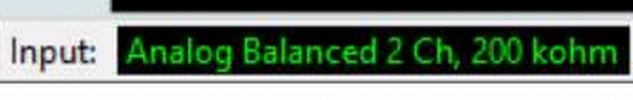

Because of that : 200k ohm's is the measurement load. Inside in the M500 Mk3, the load of the OPA1612 wich is I/V converter, is only 350 ohm's. 350 ohm on every OPA1612, each separately. The load is too little. In fact, the current, 10mA from the es9038Pro is too high for OPA1612. Es9038Pro has too big output current for common opamps. 10mA is too big for that opamp if you want the best quality of the sound. At such a current you approach to the overload protection circuit of the opamp. You need a stronger opamp or if you want, output stage.
As you can see from the measurements the 1612 with 350 Ohm is the perfect choice for the I/V stage. 1656 will double the noise
Who care about that extra-tinny noise ? We are interested in realistic sound perception, we are interested in transients that require higher and clean currents.
