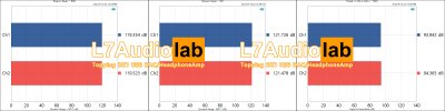

@staticV3 at 50 mV 32 Ohms recalculated to SINAD (Amir's DX5) from Wolf's THD+N % and not accounting in Wolf's SINAD is usually 1~2 dB better (better PSU probably).
50mV SNR is 90dB for the DX5 and 94dB for the DX1.
Topping DX5 Measurements Stereo 50mv Headphone Amplifier Balanced.png 1663622332-Dynamic-Range (1).jpg
I see where you're coming from.
Still, Topping's own specs which have been very accurate so far, corroborate Wolf's and Amir's 50mV SNR measurements:
With 1.7μVrms, the DX5 has 4.6dB more noise than the DX1, which is extremely close to the 4dB more noise that their 50mV SNR tests have shown.
I would therefore take Wolf's load sweep noise floor measurement as an outlier.
