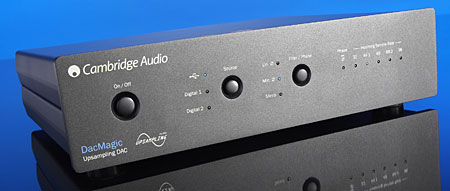

I would like to upgrade from very old CA DacMagic Azur.
I'm searching for a DAC in 200 to 300 EUR price range. Do you think that D-6S will be a good upgrade, or do you recommend and other DAC in this price range?

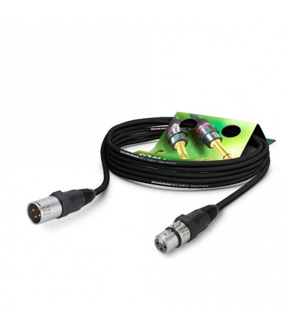

For cables I can highly recommend the Sommer Galileo 238. I use them for ages for everything XLR (Microphones, Studio-Monitors, D-6S to A20h). They are very well built and have sturdy Neutrik Plugs, absolutely nothing to complain about.
A lot of DACs in that price range, and several below it, measure well enough that you won't hear a difference in properly controlled testing. The D-6S is one of them, but check the other reviews. I haven't seen any measurements of your CA DacMagic Azur - it may be good enough that you won't hear the difference anyway (again assuming properly controlled testing.) The real differentiators are features and customer service if anything goes wrong. That's one reason to buy from a European retailer instead of direct from outside Europe.

So, is this the cable that you use:
If yes, than I will buy pair of this cable. :)

This DAC is very old, I'm using it around 15 years...
It's time to do some upgrade. ;)

Yes, it's not stellar, D6s should be a great upgrade
Kind regards
Yes, these are the cables I'm using.
