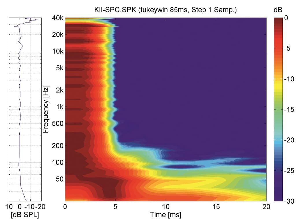

q3cpma, pretty colors. If one was to put a coin on the top of the kii3 it would start bouncing, no doubt. Maybe all speaker cabinets should be made of rubber idk. In the case of the Kii3 it is unique and interesting.
