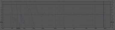

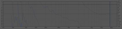

Hello,
I had already corrected my bumps and minor dips with REW and APO i have a set of genelec 8030 on a table and a svs 1000 pro. the crossover is digital at 65hz done by the sound card. I learned of rephase recently.
I only did the mid and highs as i read this was best. and unwarping the phase in low frequency seems complicated.
The 3 pictures : is first the correction estimate of the speaker (i took a close range reading (40 cm) and used paragraphic phase eq,
2nd is the result at my seating position and the
3rd was before correction.
i tried on/off the convoler in apo and I can't notice any difference in 3 listening position, i ask a firend and couldn't hear a difference. Is it because genelec have active crossover, or rephase should be used to fine tuned the phase between sub and speaker? I read on places phase cannot be heard (other than sound being cancelled and less loud)
thx for any insight

Few are able to hear post phase linearization improvement in that area. What do you think you're trying to fix or improve?
The use case for me at home is mostly for my multichannel setups where driver phase profiles do not match due to mixing and matching different speakers -- also, I prefer to keep the group delay lower than if one were to use "normal" minimum phase sub-mains crossovers.
hey thanks for the response. i was thinking it might improve the imaging or spaciousness of the sound. they have huge tutorial on how to use it. but it seems usefull in edge cases the way you mention it. REW and APO are much easier to use and by doing pink randomise noise you can record a bigger zone in less time to have a better results for eq. so i don't see why the fuss about rephase then?
Phase has to be relative to something.
If your midrange and tweeter are out-of-phase at the crossover frequency the soundwaves will cancel. In fact, a high-pass filter (the crossover network) usually introduces a phase-lead, and a low-pass a phase-lag. To correct for that, the polarity ("phase") of the midrange is often reversed in a 3-way speaker, or the tweeter in a 2-way.
Or if you reverse the wiring to one speaker (in a stereo pair) to flip the phase 180 degrees you'll get drastic cancellation of the bass and weird comb filtering at higher frequencies, especially when you move around in the room. It tends to create a "widening" effect.
But if you reverse the connection to both speakers they are back in-phase with each other and everything will sound normal again.
It might, but the 8030 is already pretty good so the change won't be drastic enough to hear easily.
Also, the effect I've noticed (if any, hard to be sure) is mostly with transients.
If you want to stress test this, just play impulses / clicks (you can use a really low frequency square wave) and see if you hear any change. That's the most extreme edge case for phase correction.
It's a just another tool... probably more suited for speaker builders/sound system designers that make extensive use of DSP e.g. equalizing phase/line arrays or very high sensitivity horn loaded compression drivers. And as already mentioned, when combining multiple different speakers in a multichannel system in order minimize lobing/cancellations/comb filtering.
Some use rePhase to create interesting improvements/results for 2-channel stereo listening with the addition of a "phase shuffler" filter: https://www.diyaudio.com/community/threads/fixing-the-stereo-phantom-center.277519/
Not so much for enhanced "imaging", but, for added "spaciousness" or immersion in an otherwise dry recording or album, there are other plugins that one can insert in the chain if you're using more flexible processing platforms such as room reverb and spatialization VSTs.
For none time-critical applications where processing latency is not so much of an issue, one can also use it to reduce the group delay:

Thx all for your answer @ernestcal, how do you reduce group delay with rew or rephase, i didn't see the optoin or settings? as well i'll try the square sine and get back to if i noticed a diffrence! thx again.
Hi, if you listen too far away, the original harmonics, meaning phase information, is ruined by room reflections. If you want to hear difference in phase you must listen close enough to the speakers in order to have fighting chance to hear "phase".
How close is it then you might ask? close enough for brain to be able to hear original harmonics I'd say! How do i know when my brain can hear original harmonics then, you might ask? And I'd say there is transition in your perception that marks whether a sound has phase information intact enough so that your brain pays attention to it. This is quite noticeable difference perceptually and you can test it just by moving closer or further from your speakers.
When you are close enough so that direct sound is sufficiently loud enough in relation to room sound, your auditory system can separate the "close and important sound" to it's own neural stream. This happens when original harmonics (iow. phase) is preserved well enough, which makes amplitude peaks sticking out loud enough above all sounds in the room and your auditory system considers this nearby important sound. Now your brain will pay involuntary attention to the sound, separate the direct sound to it's own neural stream leaving all the room sound as background stream, the envelopment. Important point is, that the perceptual change defines a point beyond which phase information is a mess to your auditory system to be considered noise, or closer it is orderly enough to deserve attention, so by definition I would think that you cannot perceive difference phase linearization makes if your auditory system cannot detect "phase" to begin with. On/off phenomenon perceptually.
There is a risk for very long post so I leave it here :D you can find at least my posts on the forum searching "audible critical distance", or go directly to source reading David Griesinger studies about Limit of Localization Distance, or Auditory Proximity.
I don't know what is your listening setup like, but could speculate that linearizing phase could move the transition, LLD, bit further into room. Also that it might have small spatial effect to sound, which you can likely hear only if you are closer to speakers than the transition. Listen how you perceive phantom image getting bit tighter for example. As I tried to explain already, by definition phase is a mess to your auditory system beyond the transition and I bet you cannot hear any difference unless you adjust your crossover dramatically so much that frequency response changes enough, or there is so long a delay the drivers have distinct echo if you purposely ruin it. I'm speculating this assuming Griesinger studies are correct and also that's what I'm hearing and not something else. From DSP with my own setup to say the same that phase is not particularly audible, and beyond the transition it is not audible. Perhaps all there is to audibility of phase is the existence of the transition, either brain pays attention to sound or not.
Thus phase linearization doesn't matter (is not audible) if room has chance to mingle it all up before your auditory system has chance to make sense of it, so logically you must be close enough to speakers to have any chance hearing it difference with phase linearization.
so i've listened to a square wave at 250hz at different %, as well bubbles from yosi horikawa. one of the listening position was close and didn't noticed difference with succesive on/off. So for now i'll leave it at that. but i'm curious for the group delay i have a peak like enerstcarl at around 220hz. i wouldn't mind playing with that to see if it improves the quality. thx again for all the comments. As well i can assure that i can localise sounds very well with the system a close range and listening position. (bubble from Yosi is a superd song to test that). thx again for all the insight
I would avoid "correcting" GD peaks above 120-140 Hz in general. We can sort of pull them down more easily below that point, but any higher increases the chances of causing unwanted audible artifacts such as pre-echo. *Also, some speaker & room systems are more amenable to phase/GD inversion -- mentioned by @tmuikku was the state of the room acoustics, for example.
thx i have 3 peaks of GD one at 45hz one at 130 and one at 220hz, if you don'T mind showing me or guiding me to a help guide on it. i won't do the 220hz to avoid pre-echo and will see if my it sounds worst or better in the end for the 2 other peaks.
thx
By inserting an FIR filter(s) that inverts some of the exhibited time domain (excess phase & GD) distortion... Yet, how to do it rather depends -- it really could go on numerous ways. But, ideally, the speaker manufacturer would have done it themselves -- for example, Hedd's linearizer plugin (which is now built-in the monitors).
