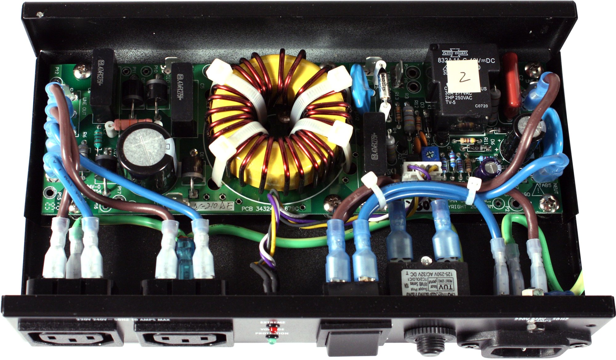

The Furman was this one: https://www.thomann.de/de/furman_ac210_power_conditioner.htm
The power strip didn't help, and yes it's SOT here. It wasn't a ground loop either, IDK what it was exactly.
Yes, that Furman model is a simple filter with overvoltage cutout as can be seen from its internals:
So probably there were just some voltage spikes. There are many potential sources of interference where I live, from heavy insustry to agriculture.
Possibly, a good quality surge protector with some filtering capabilities would probably work just as well.
Not the ones I have at home - but as said, the Furman did the trick.
