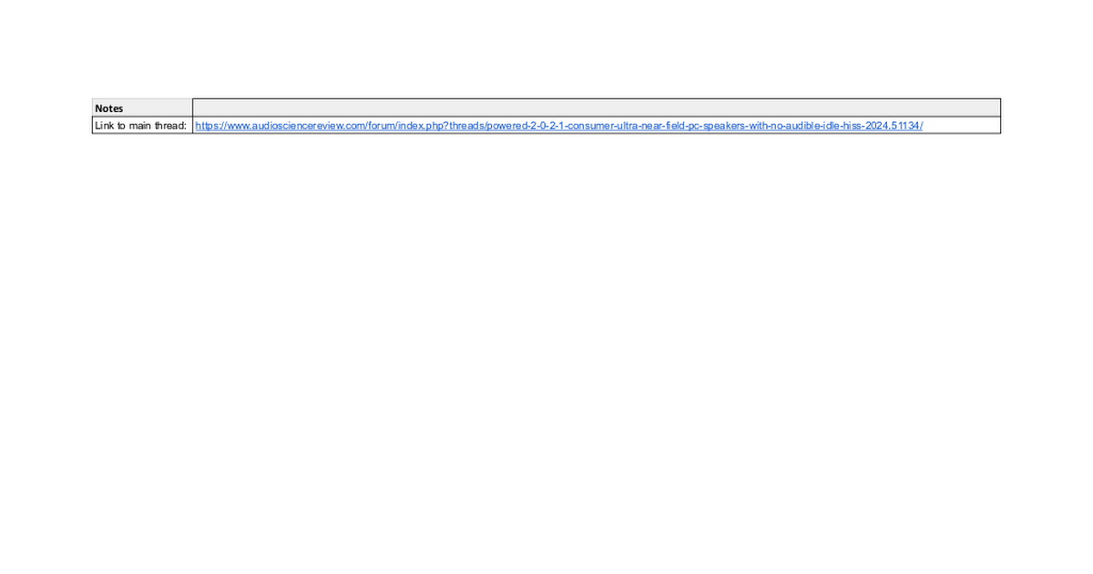

To assist with the analysis, I created a spreadsheet of Speaker Sizes:
The purpose of this spreadsheet is to get a rough sense of the size and price of desktop speaker monitors, where desktop space is a constraint. It is still a work in progress.
Just from gathering some basic dimensional data, I determined that the Kali LP-6v2 is 1266.84in³ is way too big while the newly released Yamaha HS3 is 320.32in³ (too small, relative to desired performance characteristics). The KEF LSX II is 411.45in³ and sits nicely on the desk. Basically I am looking for a speaker that is in the 400-700in³ range. It is also clear that a subwoofer is less of a necessity as the main speaker's woofer increases in diameter, but at the expense of desktop real estate.
The iLoud MTM fares nicely because it has such a small footprint at 335.14in³ (as pointed out, it has much less depth).
