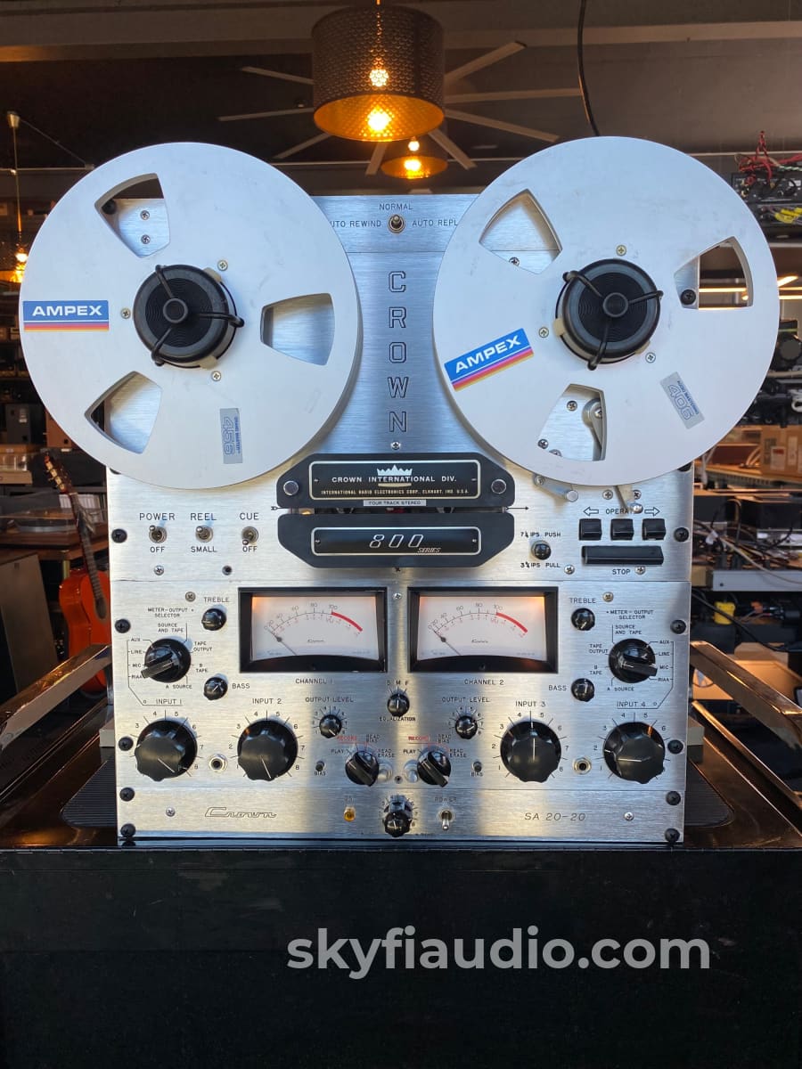

Checking out the latest and greatest arrivals at Sky Fi-- they feature a two track Crown deck. Does anyone have any experience with Crown open reel? I'd be interested in their typical application, and an opinion of Crown's overall QC and fitness (not that I'm interested in purchasing any open reel machine). Just curious. You don't read much about them.
Thinking back, in the '70s, one of our local dealers had the franchise, and I briefly listened to that deck at 7 ips. It sounded great at the time, but I never knew anyone who owned one. Plenty of ReVox and the others. But no Crowns. They looked robust, industrial/military design, were expensive and configurable. That's about the extent of my knowledge of them.
How's this for a late response? I have some experience with Crown. Overall I think the transports were less sophisticated than their competitors. If you were a high fi enthusiast they lived at the top end of the spectrum competing with Ampex, maybe Teac or Revox. By the 60's, tape was not Crown's focus as they moved into semi-pro and professional amplification (and later, microphones) and were a smaller player in the home high end of the time. My general impression of Crown recorders is that they are mechanically unsophisticated, built to compete with the smaller pro machines of the time, primarily for radio work. Or generally, that's where I saw them. IMO they were not as commercially successful as other manufacturers respecting tape but made a more meaningful mark in the studio and touring business. Now owned by Harman, it's hard to say what Crown is exactly today. I don't think they have a major manufacturing presence anymore. I'd be more inclined to fancy a Revox, Otari or Teac/Tascam than any particular Crown. There would be more and later models to chose from, parts availability would likely be easier, they have better tape handling, would be quieter assuming equal levels of maintenance had been applied. There are probably still many Crowns running and cherished, kept by enthusiastic owners who like the relatively straight forward midwestern design and think they are the bees knees. They are cool looking in their steampunk way. Therefore I apologize to any owners or fans if I have offended their sensibilities.
