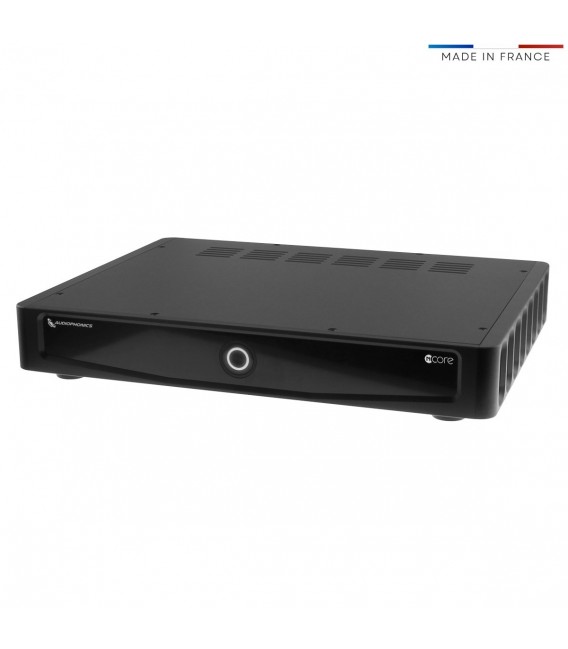

How about this one:
In budget, but it's 150W into 8R, so it's only a little bit below what you have now.

How about this one:
This do be looking quite promising actually
thank you for the recommendation!
