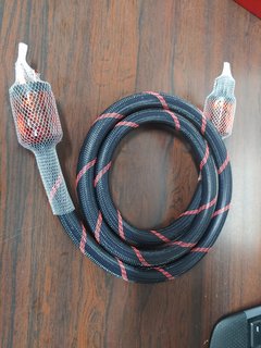

You mean just about any power chord out there?;)
Just this one: $ 6,000 for 1 m...A535D0C2-E53F-4536-953F-EFE498BDD751.jpeg
