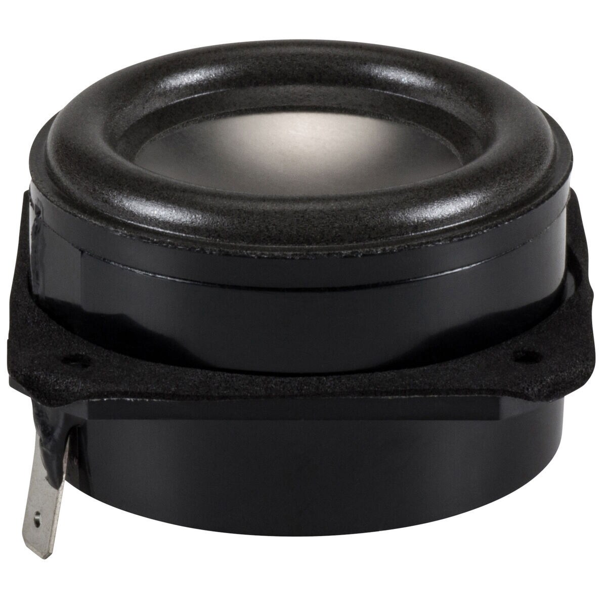

What is this ? A lot of cheap 2inch chinese fullrange?
Based on the specs Aura Whisper is a possibility.
These drivers are actually more advanced than most “hifi” drivers: underhung voicecoil with long throw, novel suspension for the inverted dome, neo-radial motor. They’re not great on the tippy top, and obviously too large to avoid beaming. A killer app for them is car audio, where the top octave is swamped by noise anyway.
