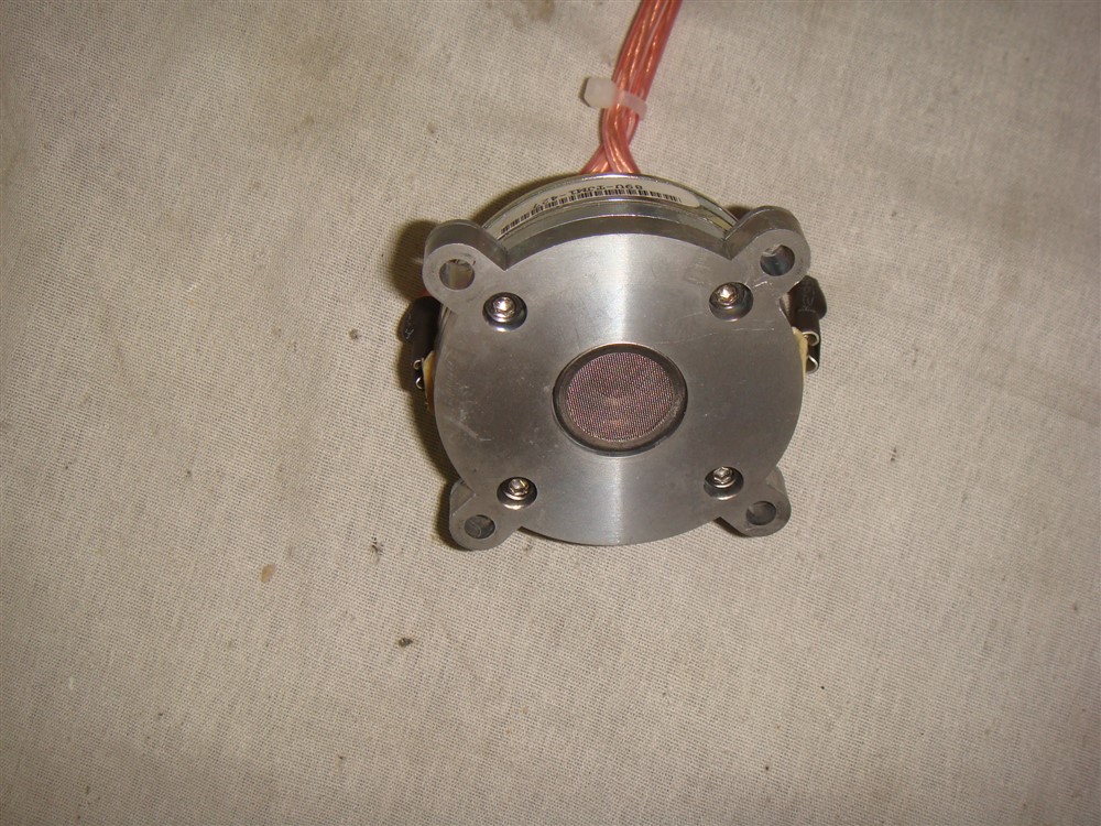

So is this using a traditional tweeter or a compression driver?
Nice to see the compression driver in this form factor. @amirm how do drums and cymbals sound at high levels? Pretty lifelike?
Some of the best I have heard!
So it's a tweeter and upper-midrange in one, it seems ("Dividing Network Transition Frequency 1,7 kHz") https://jblpro.com/products/708p (specifications).
