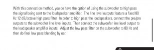

So the title says it all. How do I connect my Audiolab 6000A play to the Sb-1000 in a way my main speakers only play above 80hz? I currently have the pre outs left and right connected to the SVS and put the low pass filter on 80hz but this means my mains still play under 80 too. If my question is unclear please let me know :)

Hi @Ofty2002! Welcome to ASR.
Here's how to connect them:
External DAC->SVS Line in->SVS Line out->Audiolab Line in

Is it also possible to use this: pre out L and R to line in L and R of the svs and then svs line out L and R to audiolab ‘power’ input (the one right of the pre outs)?
I don’t want to add an external dac to my setup and would like to just use the integrated amplifier.
Yes, as long as you set the 6000A to Pre-Power Mode.

Better yet, since you already have the 6000A and some RCA cables, you can just disconnect the sub temporarily, set the 6000A to Pre-Power, connect the Pre out directly to the Power in, then test the 6000A's full functionality in this mode.
Once you're happy that everything works like you want it to, just insert the SVS between Pre out and Power in and you're good to go.
So what you mean is 6000A pre out left to 6000A power in left and 6000A pre out right to 6000A power in right? And then test if everything works as I would like it to?

Looking at doing this myself, in this mode and set up (pre out to sub, sub line out back to power in on amp) will the 6000a volume nob still control the subwoofer volume and the speaker volume?
