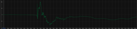

Yup, it's cause I mainly use this System for watching shows or movies.
Most of the time do I keep it at +10dB for music as well, else I...

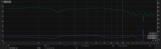

Agree with the above. Those devices have limited taps, resulting in poor LF resolution.
I use foobar convolution engine. At 88200sps, I...

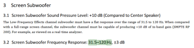

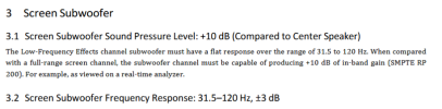

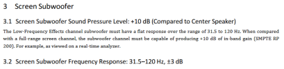

Agree, bass too hot. Could the +10dB bump be caused by LFE +10dB gain?

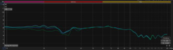

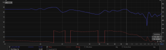

I had a look at your measurements.
Firstly, there is WAAAAAAY too much bass. About 10dB too much. What does it sound like to you...
