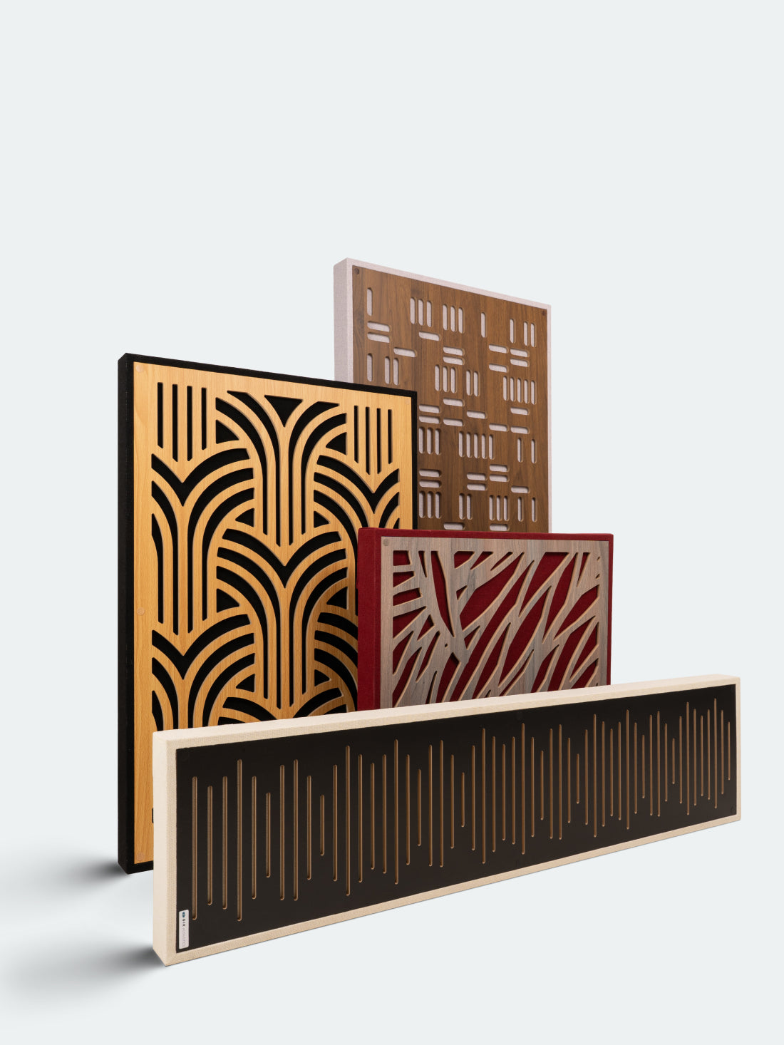

I’m sorry for the late answer. I missed your post. This is what I would if it was my room.
1- Hand a curtain as much away from the window glass as possible and as thick as you can tolerate. This will absorb reflection.
2- Hang acoustic absorbers that have solid fronts and at least 3-4cm thick on left and right walls. Do not use shaped or unshaded foam. Position them imagining they are mirrors on the wall and as if you are seeing the reflection of the speakers. Examples:
3- If you want to do more a diffuser in the ceiling will be good but not to start with. Do the first steps and listen.
